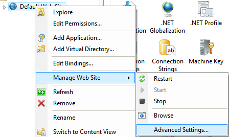

From Administrative Tools, double-click Internet Information Services.
In the Internet Information Services dialog box, expand local computer ► Sites and right click Default Website and select Edit Bindings > Manage Web Site > Advance Settings.
Expand Connection Limits, change the Time-out value to 900, and click OK.
