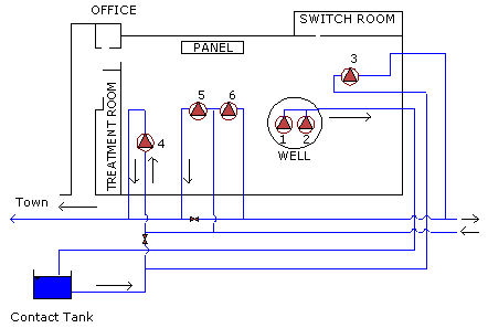

A pumping station can house several units of different types and duties, as shown in the next figure (note that there are two well pumps and four distribution pumps).
Example of a Complex Pumping Station
