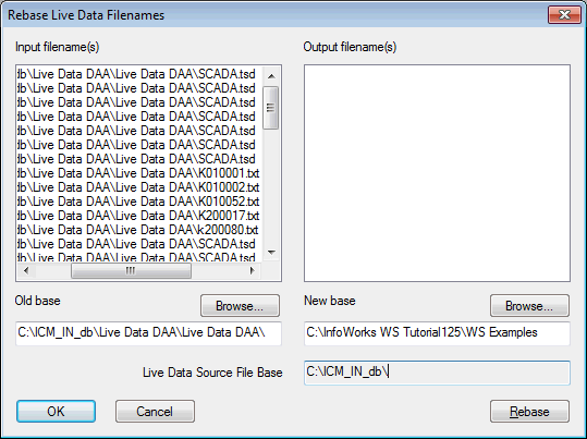

Live Data Rebase Filenames dialog
Use this dialog to change the path to Live Data files in the grid if you have moved the files to another location on your computer system.
Note:
The files are not moved by this dialog. You must move the files yourself. This dialog will just update a block of filenames, and saves you retyping each entry in the grid.
All the files selected in the grid when you open the dialog are displayed in the left hand pane. To rebase these files:
The dialog is displayed when you choose Rebase filename(s) from the context menu on the Live Data Point View.
The first picture shows the dialog before the Rebase button is clicked.

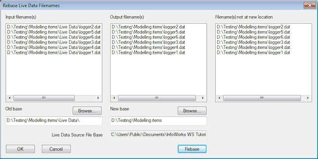

The second picture shows the dialog after the Rebase button is clicked, if some files are missing from the newly selected location. Show image
