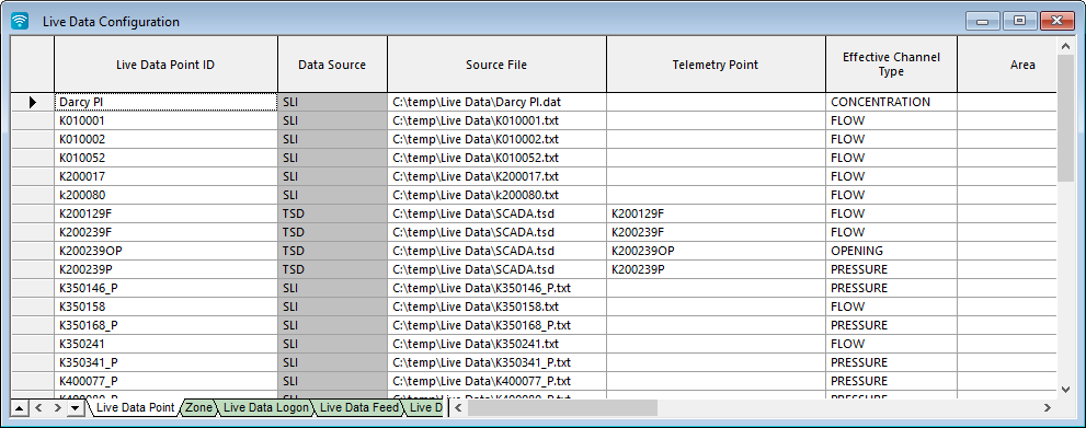

Live Data grid - Live Data Point view
This view displays two different areas of data:
The view is opened by double-clicking a live data configuration object in the Model Group window.
Notes:
Item Description
Left-most column
If clicked, selects the whole row. You can use the Shift and Ctrl keys to select multiple rows in the usual way.
A forward triangle indicates the current row.
An asterisk indicates where a new object can be created by entering its details (in this case, its name).
Data fields See Live data fields for details of the fields displayed on the grid.
