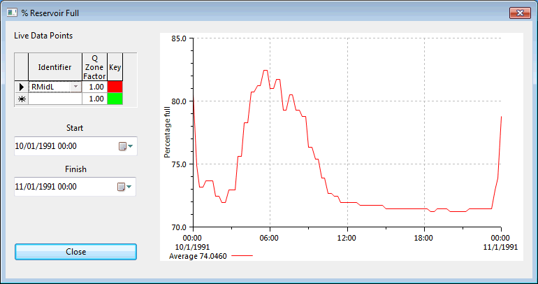

Percentage Reservoir Full dialog
This dialog is used to display a graph of percentage reservoir full.
The dialog is displayed by opening a network with associated control, right-clicking a live data point in the Live Data Point view that is associated with a reservoir in the current network, then choosing Graph % reservoir full.
Item Description
Live Data Points A grid reproduced from the Live Data Point view.
Start Sets the start time of the timescale shown on the graph.
Finish Sets the finish time of the timescale shown on the graph.
Graph display area
Graph The graph of percentage reservoir full.
Context menu Graph properties - Opens the Graph Properties dialog.
