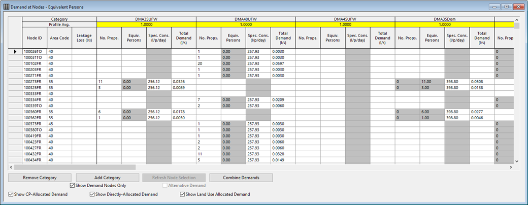

Demand at Nodes grid window
The Demand at Nodes grid view provides a central location for viewing and editing node demand. It brings together all the information from the Node Demand pages of the individual node property sheets.

View layout
Demand categories are displayed in three separate sections:
Each demand category has a number of columns with data for each node. There is a final column for total demand.
Demand categories can be set up to represent leakage, rather than consumer demand. Leakage categories are displayed separately on the right of the view, with a separate totals column.
If alternative demand is associated with the network, the alternative demand values will be displayed in the view by default. Uncheck the Alternative Demand box to view the network demands.
