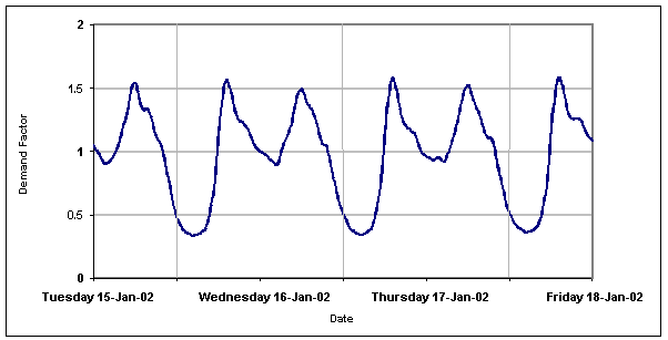

Variations of demand during the day are the most important when modelling the water supply system. The graph below shows the variations in demand over several days in a town in the UK. The daily patterns are remarkably similar, with prominent morning and evening peaks, and the same level of night consumption.
Daily Water Demand in a UK town

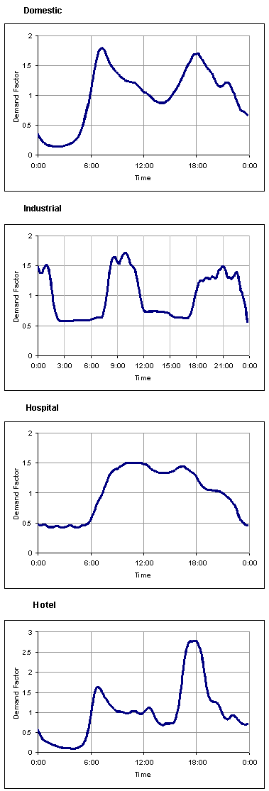

Demand in an area is made up of demand profiles of individual consumers, losses, and exceptional demand in that area. Typical profiles are often used for individual consumers in the absence of more detailed information. Some examples are shown below.
Typical Daily Profile Examples

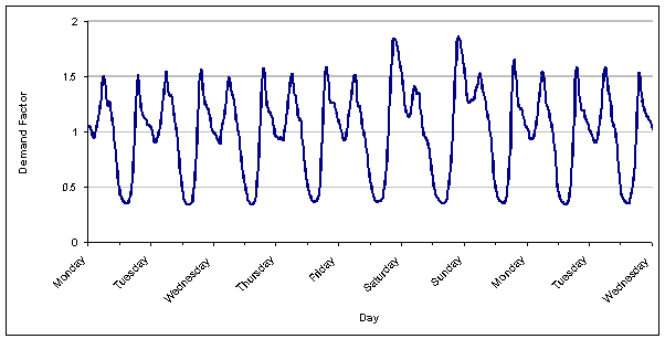

This effect may be significant in some places and some countries. The graph below shows the variation in demand over the week for a UK town. In this example, peaks occur in the morning during the weekend.
Variation in Demand through the Week in a UK town
In towns with developed industry, water demand is generally higher Monday to Friday and lower during the weekend when the industrial units are closed. In tourist resorts the opposite occurs, with peak demands occurring at weekends, when the population is increased with weekend visitors.

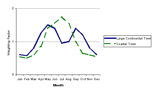

The season has a significant effect on water consumption, both in terms of overall demand and local water use. Local circumstances are predominant. These include:
The graph below shows a comparison between a large continental town and a coastal town.
Seasonal Variation in Demand
Water demand in the large continental town reaches a peak in May/June, with another smaller peak in September. During midsummer the demand is considerably lower, despite very hot weather, with many residents away on holiday. Overall demand is below the annual average.
The situation in the coastal town - a well-developed tourist resort - is quite different. Here the peak demand is very prominent, two or three times higher than the annual average, because the number of tourists considerably exceeds the domestic population during summer months.

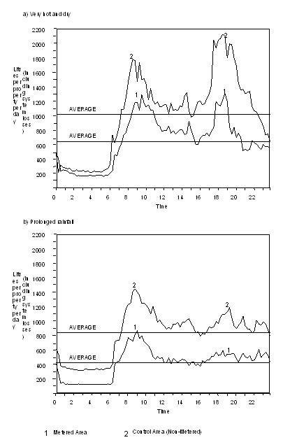

Weather conditions can be very important in some cases. The two graphs below show domestic demand patterns during metering trials in 1989 and clearly demonstrate the effects of weather conditions.
Water demand in varying weather conditions
The pattern for dry and hot weather features two prominent peaks, morning and evening. For rainy days the pattern is significantly different. The second peak has almost disappeared. If it rains, there is no need to water the garden.

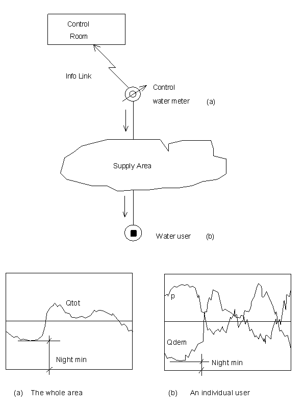

Standard practice is to increase calculated water consumption only. This is not appropriate for water supply systems, as losses behave in a quite different way to consumption. Investigations have shown that losses do not decrease during the night and increase during the day but depend mostly on the local service pressure.
Relationship of losses and service pressure
This relationship is almost linear (Leakage Control Policy and Practice (1980)) and shows that losses increase overnight.
This is confirmed by studying the water use patterns for large cities. In comparing demand patterns for the whole town to those for individual users, we find that the total demand is a smoother curve - the night minimum is higher and daily peaks are lower - than individual diagrams. Losses, between 20 and 40% of total demand in many water supply systems, are time-invariant or higher at night due to increased service pressures. This tends to level the total demand over 24 hours.
