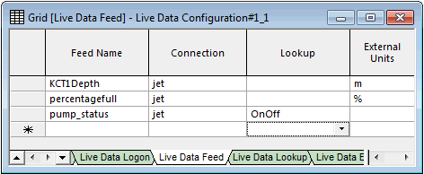

| Feed Name
User name for the telemetry data feed.
| Connection
Drop-down list of connections from the
Live Data Logon grid.
Lookup
Drop-down list of lookup tables from the
Live Data Lookup grid (Taken from the
Lookup Name field).
A blank
Lookup field indicates that no lookup table is being used for the feed.
If required, select a lookup table from the list.
Tip: Whenever a lookup table is being used for a feed, the related Offset and Factor fields (see below) become disabled and are not used when retrieving data from telemetry.
