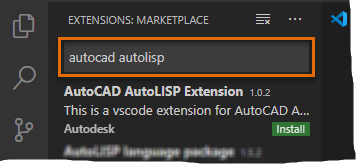

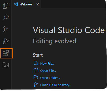

- In Visual Studio Code, on the Activity Bar, click Extensions (or click View menu > Extensions).
- In the Extensions Search box, type
autocad autolisp.
- From the search results list, click Install under the AutoCAD AutoLISP Extension item.
After a few moments, the extension should be installed and listed in the Installed Extensions list.

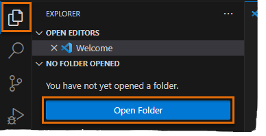

- In Visual Studio Code, on the Activity Bar, click Explorer and then click Open Folder (or click File menu > Open Folder/Open).
- In the Open Folder dialog box, browse to and select the
LSP Files folder.
- Click Select Folder on Windows or Open on Mac OS.

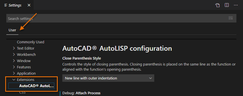

- In Visual Studio Code, click File menu > Preferences > Settings.
- On the User tab, expand Extensions and click AutoCAD AutoLISP Configuration.

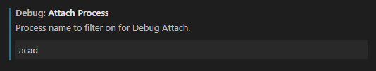

- In the Debug: Attach Process text box, enter one of the following values in bold:
- (Windows)
acad
- (Mac OS)
AutoCAD
Note: The process name is case sensitive, so acad or AutoCAD isn’t the same as ACAD or autocad.

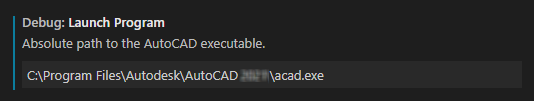

- In the Debug: Launch Program text box, enter the absolute path to the AutoCAD executable.
The absolute path varies based on the release and platform on which AutoCAD was installed.
- (Windows)
"C:\Program Files\Autodesk\AutoCAD
2025\acad.exe"
- (Mac OS)
"/Applications/Autodesk/AutoCAD
2025/AutoCAD
2025.app/Contents/MacOS/AutoCAD"
