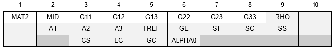

Description: Defines the material properties for linear, temperature-independent, anisotropic materials for isoparametric shell elements.
Format:
Example:
| Field | Definition | Type | Default |
| MID | Material identification number. | Integer > 0 | Required |
| Gij | The material property matrix. | Real | Required |
| RHO | Mass density. | Real or blank | 0.0 |
| Ai | Thermal expansion coefficient vector. | Real or blank | 0.0 |
| TREF | Reference temperature for the calculation of thermal loads. | Real or blank | 0.0 |
| GE | Structural element damping coefficient. See Remarks 8, 9, and 11. | Real or blank | 0.0 |
| ST, SC, SS | Allowable stresses in tension, compression, and shear, respectively. Required if composite element failure index is desired. | Real or blank | 0.0 |
| CS | Honeycomb sandwich core cell size. Required if material defines the core of a honeycomb sandwich and dimpling stability index is desired (LAM = HCS on the PCOMP entry). | Real ≥ 0.0 or blank | 0.0 |
| EC | Honeycomb sandwich core Young's modulus used for stability index analysis. | Real ≥ 0.0 or blank | E |
| GC | Honeycomb sandwich core shear modulus used for stability index analysis. | Real ≥ 0.0 or blank | G |
| ALPHA0 | Fracture angle for uniaxial transverse compression in degrees. Used in the NASA LaRC02 failure theory only (see LARC02 in PCOMP entry). See Remark 12. | 0.0 ≤ Real ≤ 90.0 | 53.0 |
