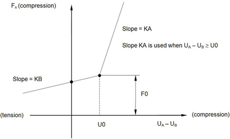

| U0 | Initial gap opening. See Figure 2 and Remark 1. | Real or AUTO | 0.0 |
| F0 | Preload. See Figure 2. | Real | 0.0 |
| KA | Axial stiffness for the closed gap (i.e. U A - U B > U0). See Figure 2. | Real > 0.0 | Required |
| KB | Axial stiffness for the open gap (i.e. U A - U B < U0). See Figure 2 and Remark 3. | Real ≥ 0.0 or blank | 10 -10 * KA |

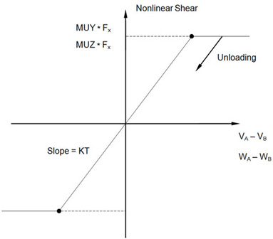

| KT | Transverse stiffness when the gap is closed. See Figure 3. It is recommended that KT ≥ (0.1 * KA). | Real ≥ 0.0 | MUY * KA |
| MUY | Coefficient of friction in the y transverse direction
. See Remark 4.
Real ≥ 0.0 | 0.0 |
| MUZ | Coefficient of friction in the z transverse direction
. See Remark 4.
Real ≥ 0.0 | 0.0 |

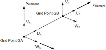

Figure 1. GAP Element Coordinate System
Figure 2. GAP Element Force-Deflection Curve for Nonlinear Analysis
Figure 3. GAP Element Shear Forces for Nonlinear Analysis
