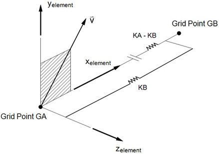

| X1, X2, X3 | Components of vector
, from GA, in the displacement coordinate system at GA (see Figure 1).
Real or blank | |

lies in the x-y plane.
Figure 1. CGAP Element Coordinate System
