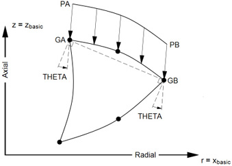

Description: Defines surface tractions to be used with solid axisymmetric elements.
Format:
Example:
| Field | Definition | Type | Default |
| SID | Load set identification number. | Integer > 0 | Required |
| EID | Element identification number. | Integer > 0 | Required |
| PA, PB | Surface tractions at grid points GA and GB. | Real | PA is the default for PB |
| GA, GB | Corner grid points. GA and GB are any two adjacent corner grid points of the element. | Integer > 0 | Required |
| THETA | Angle between surface traction and inward normal to the line segment. | Real | 0.0 |
Remarks:
Figure 1. PLOADX1 Convention on Axisymmetric Elements
