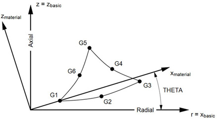

coordinate system shown in Figure 2.

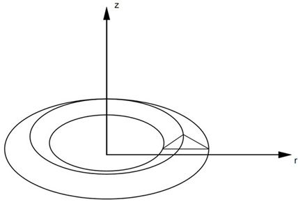

Figure 1. CTRIAX6 Element Idealization
Figure 2. CTRIAX6 Element Geometry and Coordinate Systems
