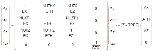

Description: Defines the material properties for linear orthotropic materials for solid axisymmetric elements.
Format:
Example:
| Field | Definition | Type | Default |
| MID | Material identification number. | Integer > 0 | Required |
| EX, ETH, EZ | Young's moduli in the x, θ , and z directions, respectively. | Real > 0.0 | Required |
| NUXTH, NUTHZ, NUZX | Poisson's ratios (coupled strain ratios in the xθ , zθ , and zx direction, respectively). | Real | Required |
| RHO | Mass density. | Real or blank | 0.0 |
| GZX | Shear modulus. | Real > 0.0 | Required |
| AX, ATH, AZ | Thermal expansion coefficients. | Real or blank | 0.0 |
| TREF | Reference temperature for the calculation of thermal loads. See Remark 8. | Real or blank | 0.0 |
| GE | Structural element damping coefficient. See Remarks 7 and 9. | Real or blank | 0.0 |
Remarks:
If either condition is not met, a warning message will be issued.
where,
