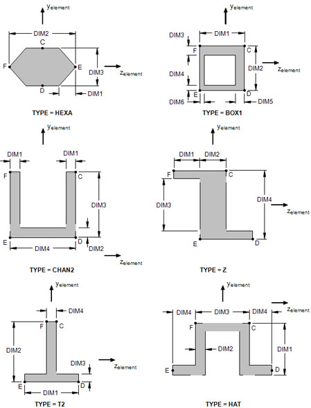

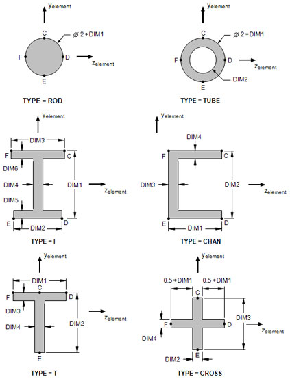

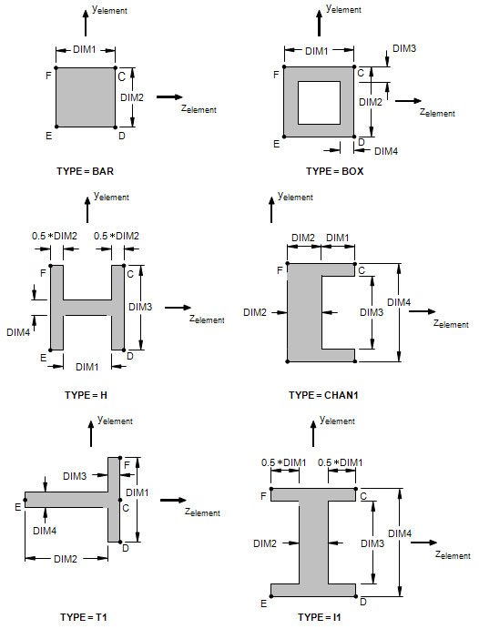

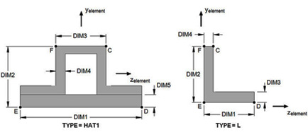

Figure 1a. Definition of Cross-Section Geometry and Stress Recovery Points
Figure 1b. Definition of Cross-Section Geometry and Stress Recovery Points
Figure 1c. Definition of Cross-Section Geometry and Stress Recovery Points
Figure 1d. Definition of Cross-Section Geometry and Stress Recovery Points
