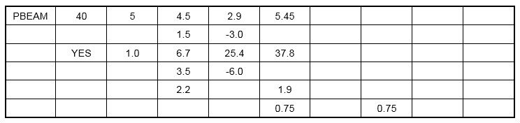

Example: Tapered beam with A = 4.5 at end A and A = 6.7 at end B.

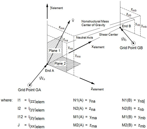

| NSI(A), NSI(B) | Nonstructural mass moment of inertia per unit length about nonstructural mass center of gravity at end A and end B. See Remark 9. | Real | 0.0, same as end A | ||||||
| M1(A), M2(A), M1(B), M2(B) | (y,z) coordinates of center of gravity of nonstructural mass for end A and end B. See Remark 9. | Real | 0.0 (no offset from shear center), same values as end A | ||||||
| N1(A), N2(A), N1(B), N2(B) | (y,z) coordinates of neutral axis for end A and end B. See Remark 9. | Real | 0.0 (no offset from shear center), same values as end A | ||||||

Figure 1. PBEAM Element Coordinate System
