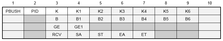

Description: Defines the nominal property values for a generalized spring and damper structural element.
Format:
Example:
| Field | Definition | Type | Default |
| PID | Property identification number. | Integer > 0 | Required |
| K | Symbol indicating that the next 1 to 6 fields are stiffness values. | Character | Required |
| Ki | Nominal stiffness values in directions 1 through 6. See Remark 2 and 3. | Real | 0.0 |
| B | Symbol indicating that the next 1 to 6 fields are force per unit velocity damping. | Character | |
| Bi | Nominal damping coefficient in units of force per unit velocity. See Remark 3. | Real | 0.0 |
| GE | Symbol indicating that the next field is the structural damping constant. | Character | |
| GE1 | Nominal structural element damping coefficient. | Real | 0.0 |
| RCV | Symbol indicating that the next 1 to 4 fields are stress coefficients. | Character | |
| SA | Stress recovery coefficient in the translational component direction 1 through 3. | Real | 1.0 |
| ST | Stress recovery coefficient in the rotational component direction 4 through 6. | Real | 1.0 |
| EA | Strain recovery coefficient in the translational component direction 1 through 3. | Real | 1.0 |
| ET | Strain recovery coefficient in the rotational component direction 4 through 6. | Real | 1.0 |
