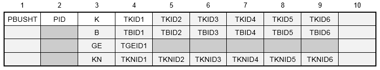

Description: Defines the frequency or force dependent properties for a generalized spring and damper structural element.
Format:
Example:
| Field | Definition | Type | Default |
| PID | Property identification number that matches the identification number on a PBUSH entry. | Integer > 0 | Required |
| K | Symbol indicating that the next 1 to 6 fields are stiffness frequency table identification numbers. | Character | |
| TKIDi | Identification number of a TABLEDi entry that defines the stiffness versus frequency relationship. | Integer ≥ 0 | 0 |
| B | Symbol indicating that the next 1 to 6 fields are force per unit velocity frequency table identification numbers. | Character | |
| TBIDi | Identification number of a TABLEDi entry that defines the force per unit velocity damping versus frequency relationship. | Integer ≥ 0 | 0 |
| GE | Symbol indicating that the next field is the structural element damping frequency table identification number. | Character | |
| TGEIDi | Identification number of a TABLEDi entry that defines the structural element damping versus frequency relationship. | Integer ≥ 0 | 0 |
| KN | Symbol indicating that the next 1 to 6 entries are nonlinear force deflection table identification numbers. | Character | |
| TKNIDi | Identification number of a TABLEDi entry that defines the force versus deflection relationship. | Integer ≥ 0 | 0 |
