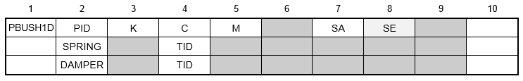

Description: Defines linear and nonlinear properties of a one-dimensional spring and damper element (CBUSH1D entry).
Format:

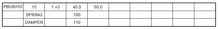

Example:
| Field | Definition | Type | Default |
| PID | Property identification number. | Integer > 0 | Required |
| K | Stiffness. See Remark 1. | Real | |
| C | Viscous damping. See Remarks 1 and 2. | Real | |
| M | Total element mass. | Real | |
| SA | Stress recovery coefficient. | Real | 1.0 |
| SE | Strain recovery coefficient. | Real | 1.0 |
| SPRING | Character string specifying that the TID in field 4 defines a nonlinear elastic spring element in terms of a force versus displacement relationship.
Character | |
| DAMPER | Character string specifying that the TID in field 4 defines a nonlinear viscous element in terms of a force versus velocity relationship.
Character | |
| TID | Identification number of a TABLEDi entry for tension and compression. | Integer > 0 | Required for SPRING or DAMPER |
