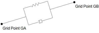

- For noncoincident grids GA ≠ GB and if CID is blank, the line GA to GB is the element axis. In nonlinear analysis with large displacement effects turned on, the element axis follows the deformation of grids GA and GB (see Figure 1).
- If CID ≥ 0 is specified, the x-axis of the CID coordinate system is the element axis. In nonlinear analysis with large displacement effects turned on, the element axis remains fixed.

Figure 1. Spring and Damper Element
