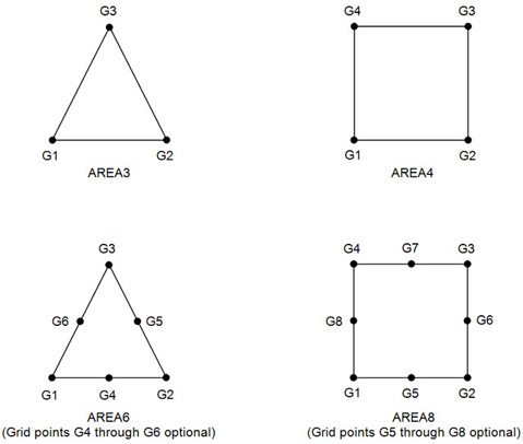

These types have three and four primary grid points, respectively, that define a triangular or quadrilateral surface and must be ordered to go around the boundary. A property entry is required for convection, radiation, or thermal vector flux (see Figures 2 and 3).

Figure 2. Surface TYPE Definition
