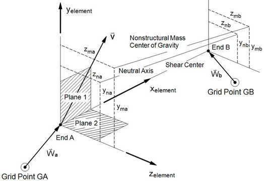

| WiA, WiB | Components of offset vectors
iA and
iB, respectively, in displacement coordinate systems at points GA and GB, respectively (see Figure 1).

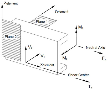

Figure 1. CBEAM Element Geometry System
Figure 2. CBEAM Internal Element Forces and Moments
