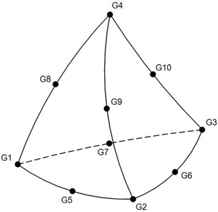

- The topology of the diagram must be preserved; i.e., G1, G2, G3 define a triangular face G1, G8, and G4 are on the same edge, etc.
- Any or all of the edge points, G5 through G10, may be deleted. If the ID of any edge connection points is left blank or set to zero (as for G8 and G9 in the example), the element equations are modified to give the correct results for the reduced number of connections. Corner grid points cannot be deleted.

- It is recommended that the edge grid points be located within the middle third of the edge.

Figure 1. CTETRA Element Connection
