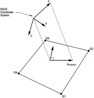

- A non-zero PCPID value in field 5 specifies a layered solid element where the ply definitions are given on the referenced PCOMP Bulk Data entry. The ply orientation is relative to the element material x-direction similar to that of a composite shell element. The element material x-direction is defined by projecting the MCID x-axis onto a surface defined by the element z-axis. The element z-axis also defines the element thickness direction. Only CHEXA and CPENTA elements may be referenced if the property defines a layered solid element.
Figure 1. Layered Solid Element MCID Coordinate System Definition
