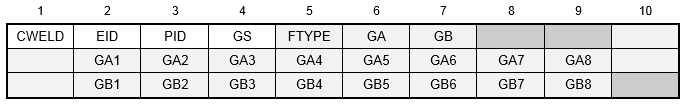

Format:

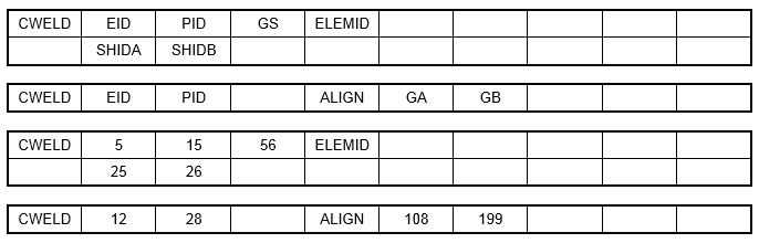

Example:
Alternate Formats and Examples:

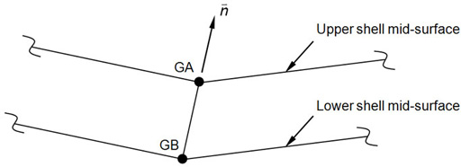

Figure 1. Patch-to-Patch Connection Defined with FTYPE Equal to GRIDID or ELEMID

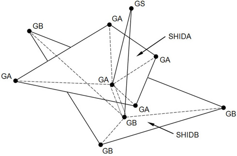

Figure 2. Patch-to-Point Connection Defined with FTYPE Equal to GRIDID or ELEMID

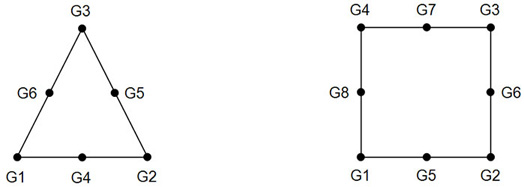

Figure 4. Triangular and Quadrilateral Surface Patches Defined with Format GRIDID
