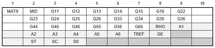

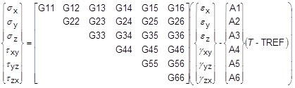

Description: Defines the material properties for linear temperature-independent, anisotropic materials for solid isoparametric elements.
Format:

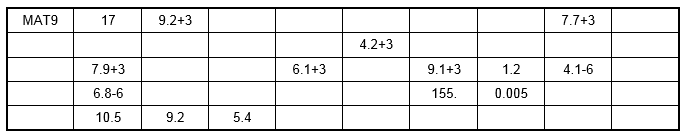

Example:

| Gij | Elements of the 6 x 6 symmetric material property matrix in the material coordinate system. | Real | Required |
| RHO | Mass density. | Real or blank | 0.0 |
| Ai | Thermal expansion coefficient vector. | Real or blank | 0.0 |
| TREF | Reference temperature for the calculation of thermal loads. | Real or blank | 0.0 |
