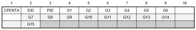

Five-Sided Solid Element Connection
Description: Defines the connections of a five-sided isoparametric solid element with six to fifteen grid points.
Format:
Example:
| Field
Definition
Type
Default
| EID
Element identification number.
Integer > 0
Required
| PID
Property identification number of a
PSOLID entry.
Integer > 0
Required
| Gi
Grid point identification numbers of connection points.
Integer ≥ 0 or blank
Required

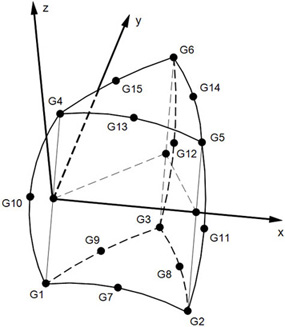

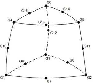

- The topology of the diagram must be preserved; i.e., G1, G2, G3 define a triangular face G1, G10, and G4 are on the same edge, etc.
- Any or all of the edge points, G7 through G15, may be deleted. If the ID of any edge connection points is left blank or set to zero (as for G11 and G13 in the example), the element equations are modified to give the correct results for the reduced number of connections. Corner grid points cannot be deleted.

- The element coordinate system is defined as follows:
The origin is located at the midpoint of a straight line joining points G1-G4. The x-axis passes through the midpoint of a straight line joining G2-G5. The z-axis is normal to a plane passing through the midpoints of straight lines joining G1-G4, G2-G5, and G3-G6.
Figure 1. CPENTA Element Connection
Figure 2. CPENTA Element Coordinate System
