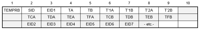

Description: Defines a temperature field for CROD and CBAR elements for determination of thermal loading and stress recovery.
Format:
Example:
Alternate Format and Example of Continuation Entry:
