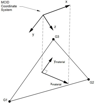

| THETA
Material property orientation angle in degrees.
Real
See Remark 5
| MCID
Material coordinate system identification number.
Integer ≥ 0
See Remark 5

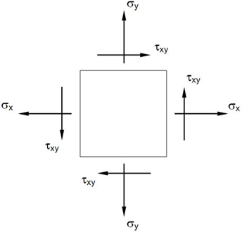

- Stresses are output in the surface coordinate system. (See the
SURFACE command in Section 3,
Case Control.)

- If THETA/MCID is blank, field 5 of the PSHELL continuation entry will be used. If this field is also blank, then THETA = 0.0 is assumed when a non-isotropic material is referenced.

Figure 1. MCID Coordinate System Definition

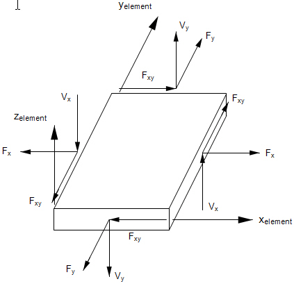

Figure 2. CTRIAR Element Geometry and Coordinate System

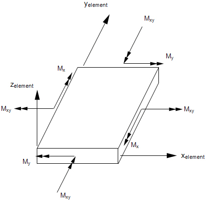

Figure 3. Forces and Moments in CTRIAR Elements
Figure 4. Stresses in CTRIAR Elements
