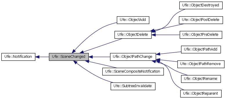

Base class for all scene notifications.
This class is the base class for all scene changed notifications.
Definition at line 25 of file sceneNotification.h.
