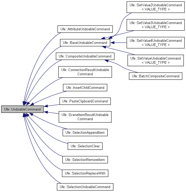

Inheritance diagram for Ufe::UndoableCommand:
