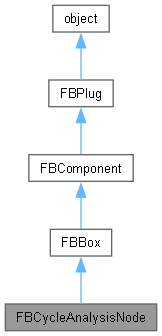

| FBCycleAnalysisNode (str pName) |
| Constructor.
FBFCurve | GetPoseFCurve () |
FBFCurve | GetRootHFCurve () |
FBFCurve | GetRootRFCurve () |
FBFCurve | GetRootSpeedFCurve () |
FBFCurve | GetRootXZFCurve () |
| FBBox (str pName) |
| Constructor.
