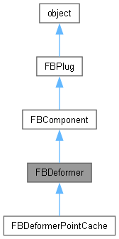

Base Model deformer class. More...
FBDeformer | ( | str | pName | ) |
Constructor.
pName | Name of deformer. |
FBDeformerType DeformerType |
Read Only Property: Deformer Type.
