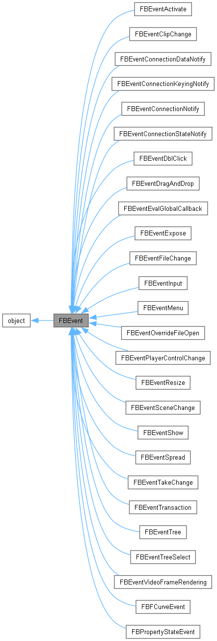

Base Event class. More...
#include <pyfbsdk.h>

Base Event class.
| FBEvent | ( | HKEvent | pEvent | ) |
Constructor.
Receives an object of type HKEvent that the corresponding callback will receive as a parameter.
| pEvent | Internal event to obtain information from. |
| int Type |
Read Only Property: Type of event.
