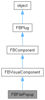

File Popup (for open/save). More...
#include <pyfbsdk.h>
