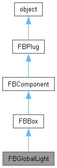

Global light class. More...

Global light class.
