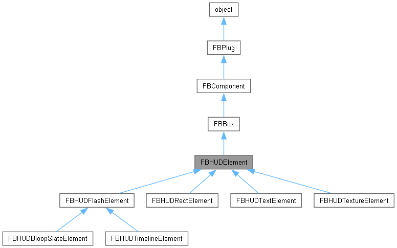

Heads Up display. More...
#include <pyfbsdk.h>

Public Attributes inherited from FBBox | |
| bool | Animatable |
| Read Write Property: Is the box animatable. | |
| bool | Live |
| Read Write Property: Is live? | |
| bool | RecordMode |
| Read Write Property: Is recording? | |
| str | UniqueName |
| internal Unique name. | |
Public Attributes inherited from FBComponent | |
| FBListComponent | Components |
| List: List of components. | |
| str | LongName |
| Read Write Property: Name and namespace for object. | |
| str | Name |
| Read Write Property: Unique name of object. See sample: RemoveSuffixFromNameOfSceneElements.py. | |
| FBListComponent | Parents |
| List: Parents. | |
| FBManager | PropertyList |
| Read Only Property: Manages all of the properties for the component. | |
| bool | Selected |
| Read Write Property: Selected property. | |
| int | TypeInfo |
| Contains the Type information of the object. | |
Public Attributes inherited from FBPlug | |
| str | ClassGroupName |
| ClassGroupName of the object. | |
| int | TypeInfo |
| TypeInfo. | |
