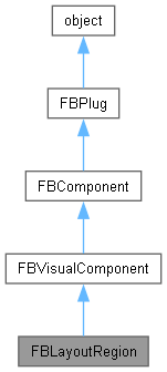

Layout region. More...
#include <pyfbsdk.h>
Public Member Functions | |
| FBLayoutRegion () | |
| Constructor. | |
Public Member Functions inherited from FBVisualComponent | |
| FBVisualComponent () | |
| Constructor. | |

Layout region.
| FBLayoutRegion | ( | ) |
Constructor.
