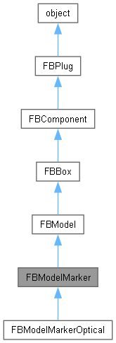

Inheritance diagram for FBModelMarker:

Detailed Description
Model marker class.
See sample: FBCamera.py.
◆ FBModelMarker()
FBModelMarker ( str  pName)
Constructor.
Parameters
pNameName of model marker. If pObject is not NULL, pName will be ignored.
Member Data Documentation
◆ Color
FBColor Color
Read Write Property: Color of model marker.
◆ IKPivot
FBVector3d IKPivot
Read Write Property: marker Pivot Offset.
◆ Length
float Length
Read Write Property: Length for capsule (not related to scaling).
◆ Look
Read Write Property: Look of model marker.
◆ ResLevel
Read Write Property: Resolution level of model marker.
◆ Size
float Size
Read Write Property: Size (not related to scaling).
◆ Type
Read Write Property: Type of model marker.
