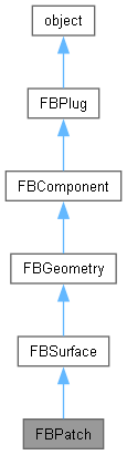

Patch class. More...
#include <pyfbsdk.h>
Public Member Functions | |

Public Member Functions inherited from FBSurface | |

Public Member Functions inherited from FBGeometry | |

Public Member Functions inherited from FBComponent | |

Patch class.
