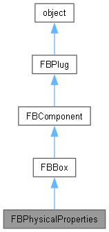

Base class for physical properties attach to a model.
See sample: RigiBody.py.
