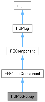

Plot Popup (for setting options only). More...
#include <pyfbsdk.h>
Public Member Functions | |
FBPlotPopup () | |
Constructor. | |
