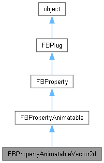

#include <pyfbsdk.h>
Public Attributes | |
FBVector2d | Data |
object | Data |
Read Write Property: The property data value. Type of this depends on the subclass of FBPropertyAnimatable (ex: in a FBPropertyAnimatableInt, Data is of type int). | |
str | Name |
Read Property: The property's name. | |
object | Data |
Read Write Property: The property data value. Type of this depends on the subclass of FBProperty (ex: in a FBPropertyInt, Data is of type int). | |
str | ClassGroupName |
ClassGroupName of the object. | |
int | TypeInfo |
TypeInfo. | |
Additional Inherited Members | |
