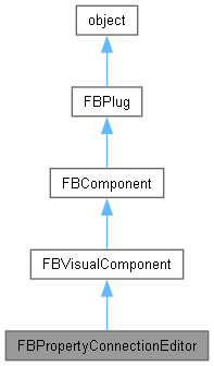

Inheritance diagram for FBPropertyConnectionEditor:
