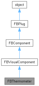

Thermometer. More...
#include <pyfbsdk.h>
Public Member Functions | |
FBThermometer () | |
Constructor. | |
Clear () | |
Reset bounds and value. | |
