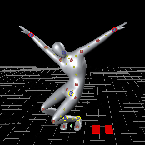

About the Python Program
The Dancing Man program described in this topic constrains a character's hip effector to the screen coordinates (x,y) of the mouse. At the end of this step-by-step tutorial, a character appears to dance in the scene when you move the mouse. The image below shows the result of The Dancing Man program.

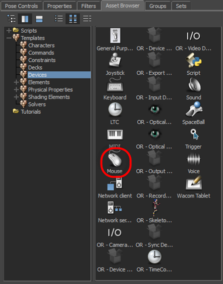

Adding a Mouse Device to the Scene
To use the mouse as an input device, you need to add a mouse (FBDevice) to the scene. You can use the FBCreateObject() function to obtain a mouse device. After the mouse object is created, you must activate it (FBDevice.OnLine), allow the application to read its data (FBBox.Live) , and append it to the scene's list of devices (FBScene.Devices).
# Create a mouse device and append it to the scene.
mouseDevice = FBCreateObject("Browsing/Templates/Devices", "Mouse", "MyMouse")
mouseDevice.OnLine = True
mouseDevice.Live = True
scene.Devices.append(mouseDevice)
The FBCreateObject() function is used to create objects from within the Asset Browser window. Following are the arguments of FBCreateObject():

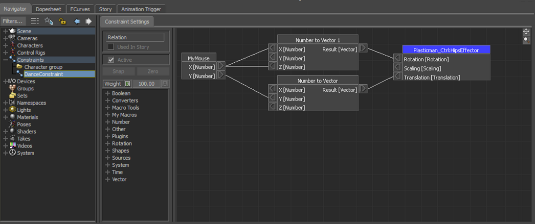

Constraining the Character's Hips Effector to the Mouse
You can now constrain the character's hips effector to the mouse input. To do this, create a new FBConstraintRelation, and name it "DanceConstraint".
# Create a constraint relation.
constraintRelation = FBConstraintRelation("DanceConstraint")
constraintRelation.Active = True
The following figure illustrates how the hips effector is constrained by the mouse. Instances of FBBox and FBAnimationNode are used in an FBConstraintRelation to define the behavior of the constraint.

FBConnect(yMouseOut, yTranslationConversionIn)
FBConnect(xMouseOut, xRotationConversionIn)
FBConnect(xMouseOut, zRotationConversionIn)
FBConnect(translationConversionOut, hipTranslationIn)
FBConnect(rotationConversionOut, hipRotationIn)
