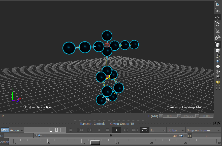

Program Summary: The following program builds on the program presented in FBCharacter - Characters. We define two new functions to make the character perform a looping "crouching" animation:
createPoses(): This function creates two poses, the first of which is the T-Pose of the character. The second pose has the character's hips effector translated to (0, 50, 0). Character poses are taken via FBCharacterPose.CopyPose().createKeys(): This function keys the character every 15 frames, according to the specified list of poses. Poses are applied to the character via FBCharacterPose.PastePose().from pyfbsdk import *

character = characterizeSkeleton(characterName, skeleton)
# Create the poses
poseList = createPoses(character)
# Create keys in the player control.
lastFrame = createKeys(character, poseList)
# Play the animation.
lPlayer = FBPlayerControl()
lPlayer.LoopStart = FBTime(0, 0, 0, 0) # Set the start time in the player control.
lPlayer.LoopStop = FBTime(0, 0, 0, lastFrame) # Set the end time in the player control.
lPlayer.LoopActive = True # Enable playback looping.
lPlayer.GotoStart() # Play the animation from the beginning.
lPlayer.Play()
