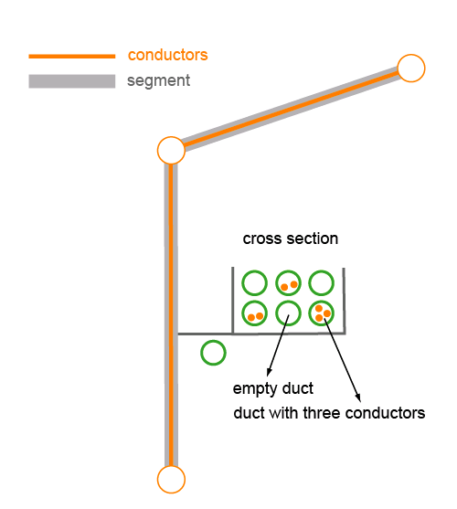

For underground networks, cross sections simplify the management of the relationships between segments, ducts, and conductors during data acquisition. Cross sections provide a cross sectional view of the following electrical elements:
In underground distribution, segments are equivalent to trenches. In overhead transmission, segments do not have a physical equivalent. They define the pathway for conductors attached to poles. Segment cross sections include snap points to facilitate conductor placement.
In addition, an extended cross section is available for the elevation view of the pole or tower (looking north or east).
In Electric NA, segments and conductors are stored with geometry but ducts are attribute feature classes without geometry. Using cross sections, you can present all elements in the map.
