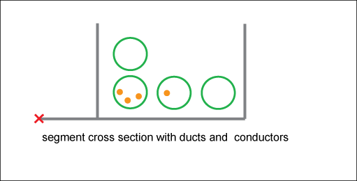

The layout and arrangement of the cross section elements can be configured. For example, you can define templates with different arrangements of conductors and ducts, or with a varying number of ducts. Add decorations and labels to enhance the cross section appearance. Cross section templates are stored in the document.
A cross section template contains the following components:
When placed in a map, the cross section shows the ducts and conductors of the current segment.
A segment cross section template contains assigned and unassigned snap points for ducts. The snap points are where ducts are inserted and where the duct cross sections are displayed.
